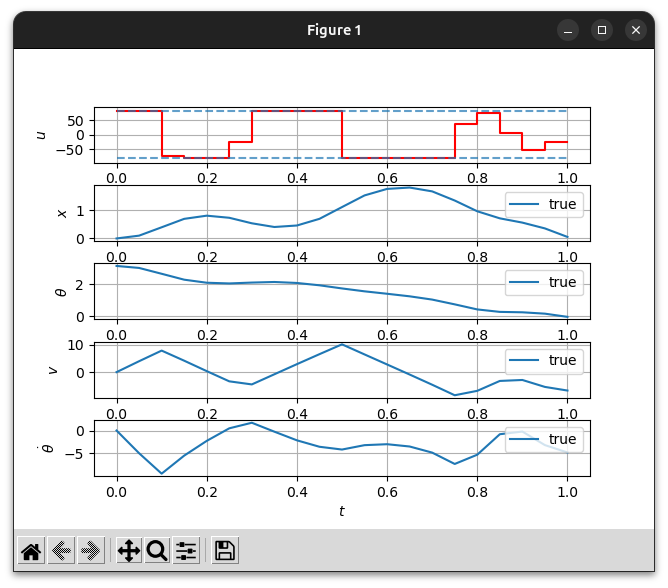

I use acados with the python interface and my issue refers to updating parameters after the solver is created:
I have noticed that the parameter values set via ocp.parameter_values before the OCP solver is created effects the solution although I updated the parameters for all stages after the solver was created and before solve() was called.
The phenomenon can be reproduced using the test_parametric_nonlinear_constaint_h.py script
Setting initial values to p_0
ocp.parameter_values = p_0
# create solver
p_set = p_0 #np.zeros(n_param)
for i in range(N):
    ocp_solver.set(i, "p", p_set)
# solve()
yield the following result graph:
Setting initial values to np.zeros(n_param and later updating with correct values p_0
ocp.parameter_values = np.zeros(n_param)

yield slightly different results:
