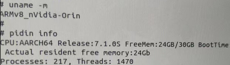

I constructed a MPC model using python and then utilized acados_template to generate theC-generation code. The model operateds flawlessly on linux platform. Subsequently i attempted to run the identical code on the QNX platform, here are modifications made to the Cmakelists in acados:
set(HPIPM_TARGET "GENERIC" CACHE STRING "HPIPM Target architecture")
set(BLASFEO_TARGET "GENERIC" CACHE STRING "Manually set BLASFEO target")
The cmake command executes successfully and generates libraries in ARM aarch64 format. Then i replace the previous x64 libraries with these newly generated ones and the cross-compiled runs successfully.

-- System name:version QNX:
-- Build type is Debug
-- OpenMP parallelization is OFF
